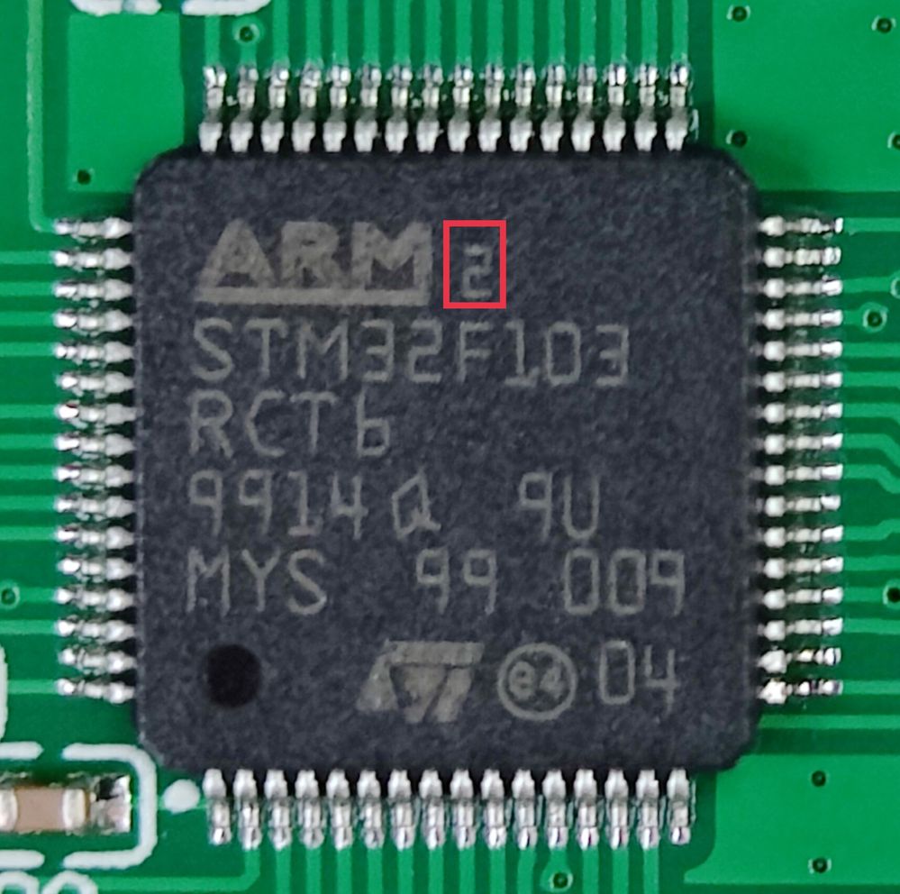

Nobody here knows what chips you're talking about.
Try specifying full part numbers, and perhaps have large clear pictures of the parts and markings you're talking about.
2021-09-10 3:08 AM
Sorry,Chip is STM32F103.
2021-09-10 3:20 AM
Ok, but still not clear on 2.3.x marking you talk about. Sounds like a code load added to a part by distributor, customer or custom manufacturer.
Most marks are lasered, not silk screened.
Take a photo, large resolution, clear and in focus.

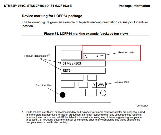

Ok, that should reflect the chip revision / die stepping
It should be readable via an DBGMCU register
The features and issues of give versions should be covered in the Errata documents.

How this impacts your design and software will depend on the peripheral usages, and coincidence with the errors/bugs in each of the respective IC design changes.
Generally ST has been very good at keeping these to a minimum, or hiding the impact in the SPL/HAL library implementations.
You'll need to go through the list, determine what might be impactful, and test/evaluate in your implementation.
This is likely to be a particular issue currently as anyone with old or surplus stock of parts is likely to be selling those via brokers, etc, leading to a random mix, rather than the freshest version of the part straight out of the fab.
