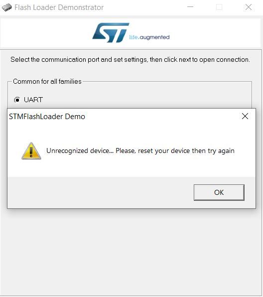

In the description of the STSW-STM32102 you can find:
Virtual COM port driver installation package for Windows® operating systems: 98SE, 2000, XP, Vista®, 7, and 8.x
Windows 10 does not require the installation of the Virtual COM Port driver anymore, as it is already built in.
But for the SPracingF3 there are a lot of forums out there dedicated to flashing that may be able to help you.
Good luck!
/Peter
2020-08-11 7:02 AM
Should you be using the DFU Programming mode, rather than the serial one?
How does the device present in the Device Manager?
2020-08-12 2:23 AM
he is in the com port.
2020-08-12 2:29 AM
Thanks Peter, yes I watched the videos. they also use the Zadig program but you still need a stm32 bootloader software which is in the circuit but impossible to see it for an uploader ...
2020-08-12 2:31 AM
Ok thanks Clive for the information. stm is not visible in the peripherals, only the card that I connect in the com port
