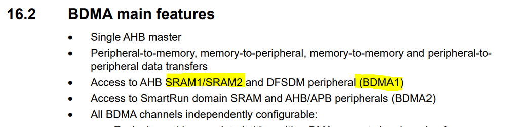

2020-08-11 5:24 AM
BDMA1 doesn't have access to SRAM3.
There is some useful information in the reference manual about these peripherals.
A BDMA "channel" is functionally equivalent to a DMA "stream". The latter uses the DMAMUX to map a stream to different request generators. In familites without a DMAMUX, a DMA stream needed to be mapped by selecting one of 8 or so channels.
