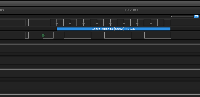

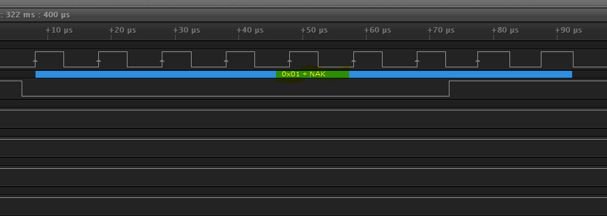

I am trying to interface IC ADS1115(ADC) with STM32F401RE through I2C communication.I am not getting ACK from Slave after writing data to Config register.But getting ACK for device address(0x92) and also in I2C1->SR1 register AF-Acknowlege failure bit is getting set as attached below.Any kind of inputs would be appreciated.

Default address for ADS1115 is 0x4A (can be changed to 0x4B an so on...)
Shifted 1bit left for RW bit it gives 0x94/95 but no way 0x92. ADS ignores your requests.
