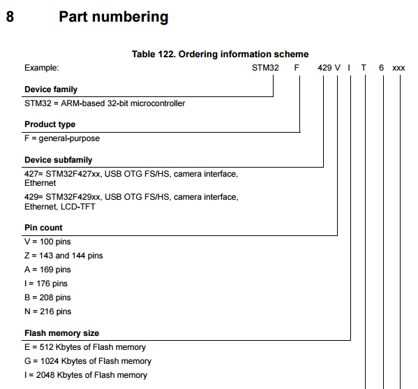

Incomplete reading of the datasheet? Here an interesting snapshot: IGT6 or IIT6 ?
2017-08-26 7:41 AM

Mouser says 1MB when you Google Part#
2017-08-26 11:36 PM
Thanks KIC and Clive. Got it. So I need to go for STM32F429IIT6.
