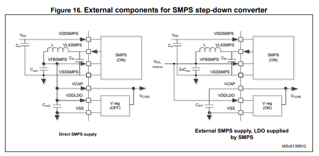

at the datasheet:
LDO only - can work with VOS0
SMPS directly cant work with VOS0.
SMPS on and supplies only the LDO - ?
2023-01-26 3:22 AM
Hello @IGAL TALOR ,
For STM32H755xxx3 sales types (industrial temperature range) the voltage regulator output can be set only to VOS2 or VOS3 in Run mode.
The different hardware configurations for power supply is mentioned in DS12919 figure 16: Direct SMPS supply and External SMPS supply, LDO supplied by SMPS.
When your question is answered, please close this topic by choosing Select as Best. This will help other users find that answer faster.
Kaouthar

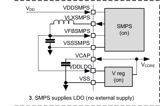

the schematic:
2023-01-26 3:22 AM
Hello @IGAL TALOR ,
Kaouthar
