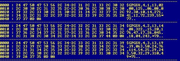

The receiver isn't sending the \r\n characters literally, it is sending them as 0x0D and 0x0A bytes, like $ is 0x24
2021-08-24 11:23 PM
So this was super helpful, I did have UBX packets being sent, and that was causing all kinds of problems as I was building under the assumption that I only had the one message type enabled.
I cracked open the interface manual that goes with this chip and I think it is actually sending \r\n literally.
Also I figured the message length could change, and turns out it can vary a little. So instead of looking for the $ and getting the next N bytes. I made the buffer larger than max message length. I look for the $ byte, and know I now have the previous msg in buffer, process it, clear buffer, stick $ back at the front.
And that now all works perfectly. Thank you for all the help!
