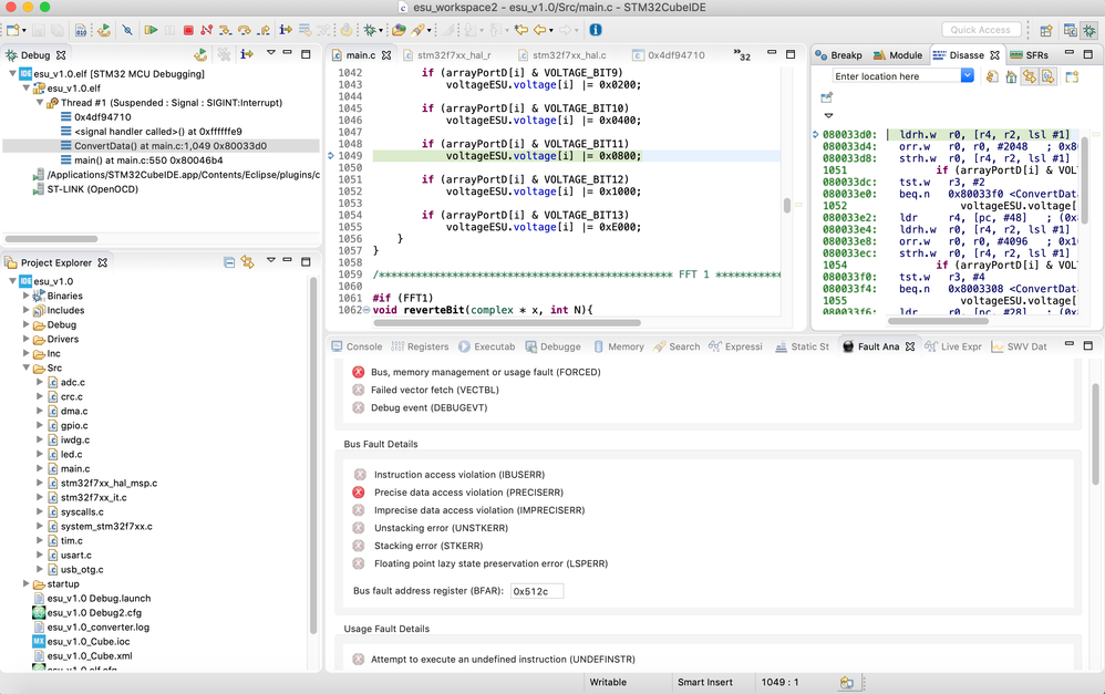

Some times happen other hardfault, like:
2019-07-16 3:58 PM
can you check the call stack ?
generally I guess you have an interrupt where the buffer pointer is not within bounds
2019-07-16 4:23 PM
Register content at fault would be helpful. Precise suggests it is the read/load failing.
Would be less difficult to track down if your Hard Fault handler output some useful data vs while(1)
Stack checks aren't hard to implement either.

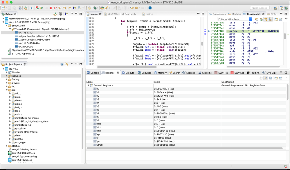

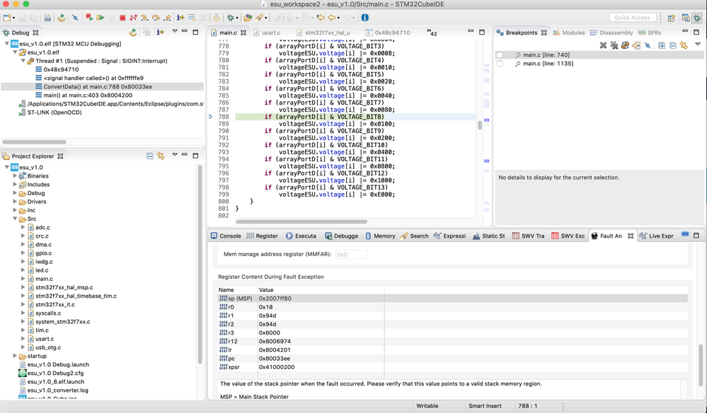

2019-07-23 5:16 PM
Hi, guys, here are the registers at the fault.
Is it something related to my stack been corrupted? How can I track it down?
2019-07-23 6:18 PM
Ok, that's a subset of the registers, the index is in R4 from the prior disassembly, but it is halfway through some code that is doing materially the same thing.
You'd perhaps fill the stack with a known pattern you can see in registers later, or check in a data dump of the stack area.
Determine which interrupts you have firing. Perhaps output a character to the terminal at entry/exit from those interrupts to identify any pattern to the failure.
Check your (excessive) use of auto/local variables in these interrupts and callbacks, and functions called inside them.

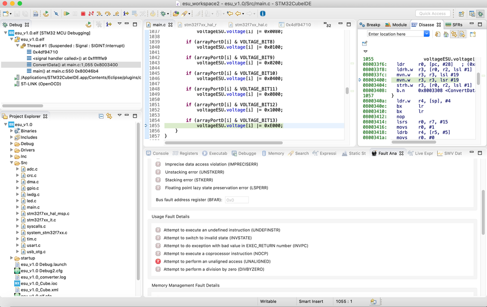

2019-08-15 4:35 AM
Hi, the only interrupt a use is a DMA interrupt, to get values from GPIO PortD register and send them to memory, is a big amount of data, like 10240 bytes.
Now the code is throwing even more the hard fault I don't now why.
I use a PWM to generate the dma request to get the data from GPIO PortD, after get the data I perform a FFT, at this time every single time I get a hard fault, apparently I don't see any errors in the code, here is the hard fault and the code.
The FFT function is in the CalcProcedure function.
uint16_t timeout = 0;
while(1)
MX_DMA2_Init();

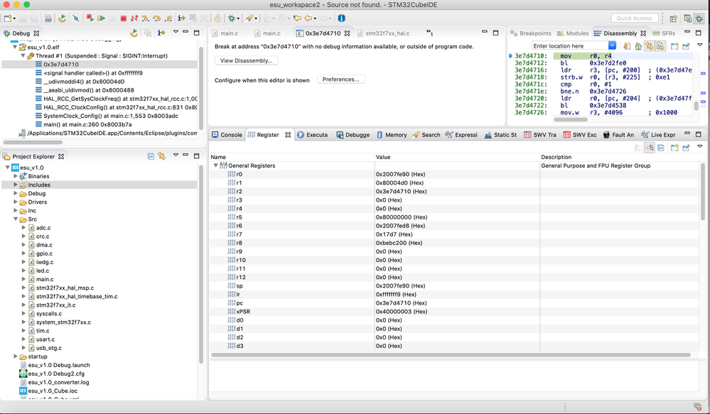

2019-08-15 4:43 AM
I thing maybe is some related with the RCC or system clock, or even my HSE clock, because some times I'm getting hardfault during HAL_Delay, or during clock init. Liked the photo below.
2019-08-15 4:47 AM
Looks to be branching to an invalid address (pc via r2), perhaps clash of stack/heap
I use my own handler,
https://community.st.com/s/global-search/after%20joseph
Figure flow of code with instrumentation, and sanity check pointer, stack and heap.
