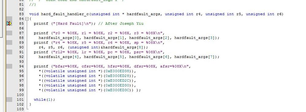

In Keil, I do it this way..
HardFault_Handler\
PROC
EXPORT HardFault_Handler
TST lr, #4 ; Determine correct stack
ITE EQ
MRSEQ R0, MSP ; Read MSP (Main)
MRSNE R0, PSP ; Read PSP (Process)
MOV R1, R4 ; Registers R4-R6
MOV R2, R5
MOV R3, R6 ; sourcer32@gmail.com
EXTERN hard_fault_handler_c
B hard_fault_handler_c
ENDP
void hard_fault_handler_c(unsigned int * hardfault_args, unsigned int r4, unsigned int r5, unsigned int r6)
printf (''[Hard Fault]
''); // After Joseph Yiu
printf (''r0 = %08X, r1 = %08X, r2 = %08X, r3 = %08
X'',
hardfault_args[0], hardfault_args[1], hardfault_args[2], hardfault_args[3]);
printf (''r4 = %08X, r5 = %08X, r6 = %08X, sp = %08
X'',
r4, r5, r6, (unsigned int)&hardfault_args[8]);
printf (''r12= %08X, lr = %08X, pc = %08X, psr= %08
X'',
hardfault_args[4], hardfault_args[5], hardfault_args[6], hardfault_args[7]);
printf (''bfar=%08X, cfsr=%08X, hfsr=%08X, dfsr=%08X, afsr=%08
X'',
*((volatile unsigned int *)(0xE000ED38)),
*((volatile unsigned int *)(0xE000ED28)),
*((volatile unsigned int *)(0xE000ED2C)),
*((volatile unsigned int *)(0xE000ED30)),
*((volatile unsigned int *)(0xE000ED3C)) );
while(1);

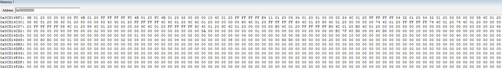

Thank you for your answer but I don't undestand what I have to do. I'm a junior programmer and there are some functionalities which I don't know but I would like to learn. ''You should fill the stack with a pattern you can recognize in the debuggers ''Memory View'' and confirm how much you are using, and the state of the return addresses it is about to pop off the stack.''I've open Memory 1 tap view but I don't know what I have to view. If you want tell me is that in which memory address the code is all 00, it starts in 0x3CD14CB3.2016-08-03 4:08 AM

So, how can I add variables as your example?
Thanks
2016-08-03 6:03 AM

If you want to replace the Hard Fault Handler, then you're going to need to cut-n-paste the new assembler code into startup.s and replace the current handler (ie remove/rename) with the alternate C code I've provided. You'd also need to provide sufficient hosting in your system to support printf() output to a USART or SWV debug channel.

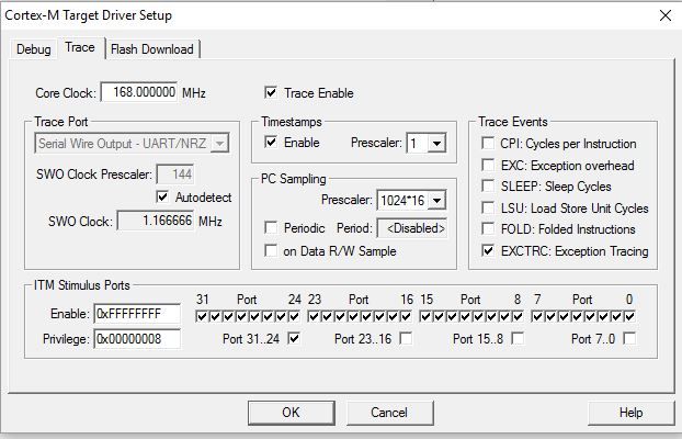

Yestarday I had some problems to replay you. I'm thirty but only 8 month ago I'm working with STM32 devices. I'm new in Keil and with this environment. I've tried your advice, but I have other problem. I can't printf. I have an ULINK2/ME which can SWD but I don't know why when the system arrives at printf it hangs.RCC_OscInitStruct.OscillatorType = RCC_OSCILLATORTYPE_HSE;
RCC_OscInitStruct.PLL.PLLM = 8;
RCC_OscInitStruct.PLL.PLLN = 336;
RCC_OscInitStruct.PLL.PLLP = RCC_PLLP_DIV2;
RCC_OscInitStruct.PLL.PLLQ = 7;
HAL_RCC_OscConfig(&RCC_OscInitStruct);
What is it happen?
Certainly the stack is defined as 0x900
2016-08-04 8:57 AM
