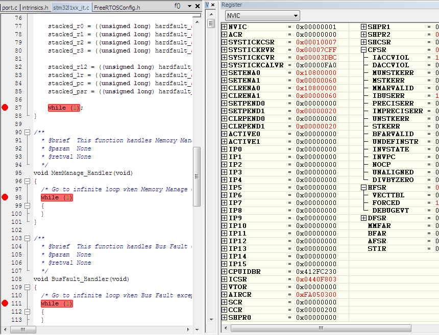

but the execution doesnt stop at breakpoints of the respective handlers is it because the fault address of the above errors is not written in BFAR and MMAR.
about stack, while creating tasks i am multiplying the configMINIMAL_STACK_SIZE with the num, to allocate stack to tasks. also sometimes the execution stops @ prvTaskExitError() do you know how to debug this?2014-03-25 10:20 AM
I guess that there is no chance that MemManage and BusFault handler trigger if they haven't been activated properly (show us SHCSR value).
