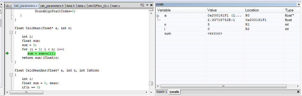

I'm using the STM32F4 on the discovery evaluation board.I wrote a simple function that calculates the mean of a vector. When the code is starting to make the summation it goes to HardFault_Handler...Here is the mean function, a moment before the exception:2013-05-16 5:38 AM

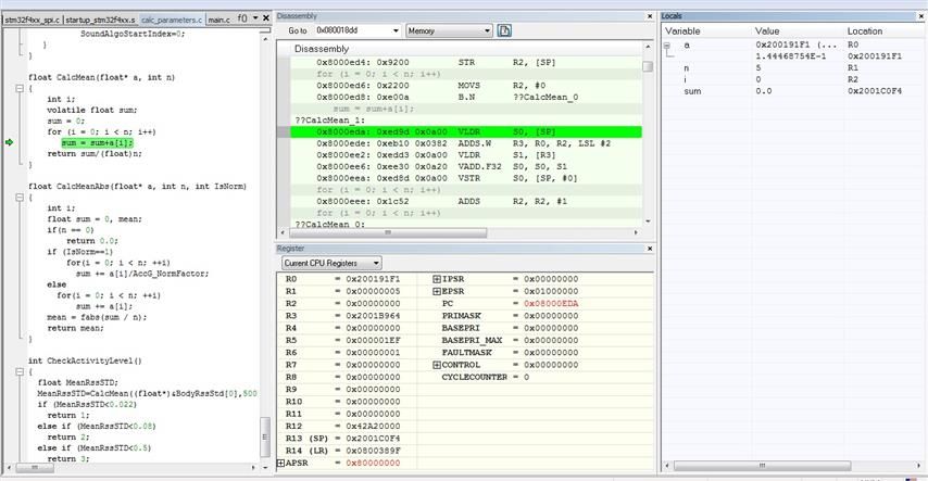

Attached is a print screen of the code, registers, locals, and assembly code.When I hit F10 I get the hard fault exception.I'll appreciate your help.Thanks,Yoav2013-05-20 7:58 AM
Honestly it still looks to be a problem with the FPU.
Check SCB->CPACR Check __FPU_PRESENT and __FPU_USED defines. In main(), something like printf(''CPACR:%08X FPU:%d %d\n'', SCB->CPACR, __FPU_PRESENT, __FPU_USED};2013-05-21 2:16 AM
