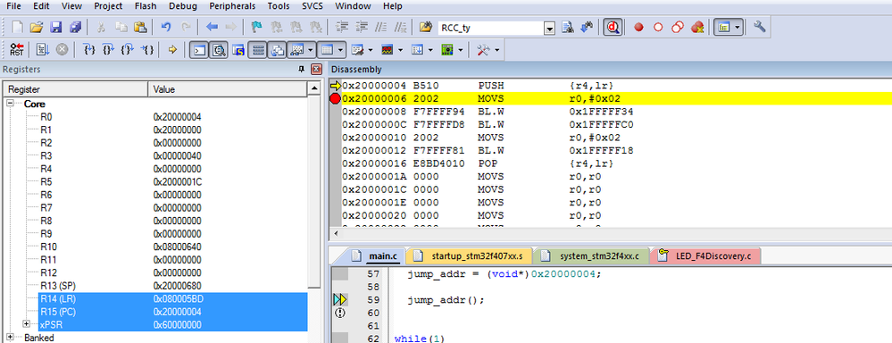

I am using stm32f407 discovery board and when i tried to execute the code stored in the SRAM i am getting hardfault exception . the instructions are indeed valid.
i have attached the screenshot which shows the PC, SP, and disassembly code. please help me solve this issue.
In this window the processor is ready to execute the PUSH instruction , and when i hit ''step in'' button i goes to hardfault handler.

Supposedly normal SRAM.
How do you jump to your RAM code ?
Are you aware of the ARM/Thumb code difference, and how the core distinguishes both ?
2017-10-14 10:14 AM
The branches to subroutines look like they will be problematic..
Also jump_addr of 0x20000004 will be a problem, should be 0x20000005, as the core can't execute 32-bit code, and WILL fault.
It will help significantly working at this level of processor functionality to read and understand the core's documentation.
This means, the LSB of the jump address must always been set on a Cortex M, this bit serves to distinguish between ARM and thumb code.
The Cortex M does not support ARM code, and will hardfault on it.
Usually, the compiler does this for you.

The code needs to be built for 0x20000000 if that's the final destination, you'll also need to move the RAM used by the statics deeper into memory, ie 0x20002000 if you other code takes 8KB
You can do this via a Scatter file, or by changing the target IROM/IRAM settings for the code you want to load into RAM.
The Cortex-Mx series can only execute Thumb code, that cannot execute 32-bit ARM code. The jump addresses used for function pointers will be ODD
