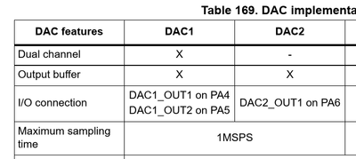

I am looking to develop with the STM32 microcontrollers for the first time and was hoping to get some help. I need to create a device capable of outputting 3 separate sawtooth waves that are individually controllable to synthesize audio based on user input. I was looking at the STM32G431K6T6 or something similar, as it has a development board, the NUCLEO-G431KB, and claims to have 4 DACs. I am confused about this however. It says that 2 DACs are external and 2 are internal. Does this mean that only 2 can be sent to external circuitry? Is there any way to get 3 observable and individually controllable waves out of this device? Also from what I've read, it seems that the way to create a sawtooth wave is to increment the DACs output and reset it with a timer. Since these timers are configured in STM32Cube with prescalers etc. is there a way to actually change the frequency of the DACs wave after the code is running?

Not all dacs have output to pins, but seems your lucky :  3 have...
(This is different to description in ds :
-- maybe STM knows, what they build...)
Do a simple test to prove it :
in stm32Cube or - IDE , start new project, with this chip, you want to use (or is on nucleo board),
and set the dacs -> to output pins ; then you see: will it work, to get 3 dac signals out (or only 2 ).
