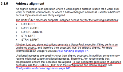

Just for your info, from PM0253:
So look at your generated assembly code and check if there is no instruction outside the list above then check the UNALIGN_TRP bit in SCB_CCR register. If it's set, reset it.
