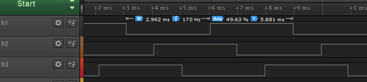

i am working on a bldc motor project for school, and for start to understand whats happening inside the IRQ handler, i have configured timer2 on ch1,2,3 with 3 emulated hardware signals, imitating the CW of a bldc motors
The hall emulated signals are coming from another development board. The signals are bellow
These signals ( H1,H2,H3) are feed into a STM32F407 device, on PA0, PA1 and PA2 which are Ch1,2,3 of the TIMER2
i have prepared only the initialization of the timer2 to see if the hall signals trigger the CC1 event in the irq handler, but its not triggering.
I've put a small toggle on a PC1 pin just to see when its triggering inside the TIM2_IRQhandler,
But there is no triggering,
At this point Timer1 is not initialized, i just want to see how it behaives on the hall signals.
I am missing something? Of does the Timer2 takes some kind of feedback from TIM1 in order to trigger CC1 event?

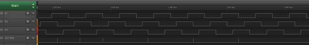

Ok, now that my IRQ handler is working, i started the following code, i modifyied my timebase to overflow at arround 500 ms
My Hall signals each are 2.9 ms at 50% dutycycle.
Basicaly i have a hall event at every 1ms
The problem is that the CC1 interrupt should occour at every hall rising edge, is this correct?
But from the logic analyzer i see the CC1 is fired haoticaly, and i wonder why....
Here is my code
int main(void){
GPIO_InitTypeDef GPIO_InitStructure;RCC_APB1PeriphClockCmd(RCC_APB1Periph_TIM2, ENABLE);
RCC_AHB1PeriphClockCmd(RCC_AHB1Periph_GPIOC, ENABLE);RCC_AHB1PeriphClockCmd(RCC_AHB1Periph_GPIOA, ENABLE);GPIO_InitStructure.GPIO_Pin = GPIO_Pin_0 | GPIO_Pin_1 |GPIO_Pin_2;GPIO_InitStructure.GPIO_Mode = GPIO_Mode_AF;GPIO_InitStructure.GPIO_Speed = GPIO_Speed_100MHz;GPIO_InitStructure.GPIO_OType = GPIO_OType_PP;GPIO_InitStructure.GPIO_PuPd = GPIO_PuPd_NOPULL ;GPIO_Init(GPIOA, &GPIO_InitStructure);GPIO_PinAFConfig(GPIOA, GPIO_PinSource0, GPIO_AF_TIM2);
GPIO_PinAFConfig(GPIOA, GPIO_PinSource1, GPIO_AF_TIM2);GPIO_PinAFConfig(GPIOA, GPIO_PinSource2, GPIO_AF_TIM2);//**** PC1 is used for toggle in IRQ handlers to see with logic analyzerGPIO_InitStructure.GPIO_Pin = GPIO_Pin_1 |GPIO_Pin_3 ;GPIO_InitStructure.GPIO_Mode = GPIO_Mode_OUT;GPIO_InitStructure.GPIO_Speed = GPIO_Speed_50MHz;GPIO_InitStructure.GPIO_OType = GPIO_OType_PP;GPIO_InitStructure.GPIO_PuPd = GPIO_PuPd_UP ;GPIO_Init(GPIOC, &GPIO_InitStructure);NVIC_InitStructure.NVIC_IRQChannel = TIM2_IRQn; NVIC_InitStructure.NVIC_IRQChannelPreemptionPriority = 7; NVIC_InitStructure.NVIC_IRQChannelSubPriority = 7; NVIC_InitStructure.NVIC_IRQChannelCmd = ENABLE; NVIC_Init(&NVIC_InitStructure);TIM_TimeBaseStructure.TIM_Prescaler = 647;
TIM_TimeBaseStructure.TIM_CounterMode = TIM_CounterMode_Up; TIM_TimeBaseStructure.TIM_Period = 65000; TIM_TimeBaseStructure.TIM_ClockDivision = 0; TIM_TimeBaseStructure.TIM_RepetitionCounter = 0; TIM_TimeBaseInit(TIM2, &TIM_TimeBaseStructure);TIM_SelectHallSensor(TIM2, ENABLE);
TIM_SelectInputTrigger(TIM2, TIM_TS_TI1F_ED); TIM_SelectSlaveMode(TIM2, TIM_SlaveMode_Reset);TIM_SelectMasterSlaveMode(TIM2, TIM_MasterSlaveMode_Enable);
TIM_ICInitStructure.TIM_Channel = TIM_Channel_1 ; TIM_ICInitStructure.TIM_ICPolarity = TIM_ICPolarity_Rising;TIM_ICInitStructure.TIM_ICSelection = TIM_ICSelection_TRC;// listen to T1, the HallSensorEvent TIM_ICInitStructure.TIM_ICPrescaler = TIM_ICPSC_DIV1;TIM_ICInitStructure.TIM_ICFilter = 0x0F;TIM_ICInit(TIM2, &TIM_ICInitStructure);// Enable CC1 interrupt requestTIM_ITConfig(TIM2, TIM_IT_CC1, ENABLE);TIM_Cmd(TIM2, ENABLE);while(1){}
void TIM2_IRQHandler(void){
if (TIM_GetITStatus(TIM2, TIM_IT_CC1) != RESET) { TIM_ClearITPendingBit(TIM2, TIM_IT_CC1); GPIOC->BSRRH = GPIO_Pin_1; //reset GPIOC->BSRRL = GPIO_Pin_1; //set GPIOC->BSRRH = GPIO_Pin_1; //reset }2017-01-13 9:58 AM
Hi
Anton.Bogdan
,Pleasetry with a basic configuration without using the filter :
TIM_ICInitStructure.TIM_ICFilter = 0;
And send me a new screen shot of the signals seen on the analyser.
Khouloud.

In the end i solved'it, it was because of the GPIO PullUP enabled for the 6pwm outputs, after configured with NOPULL everything is as expected.
Thanks guys
