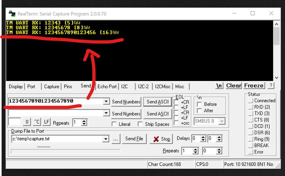

}everything works, for example I tried to send first 5 characters, then 8 characters and everything is fine, but if I try to send a package longer than 16 characters, only the first 16 characters are read and then everything freezes and no more data is received from the UART.
I don't understand why everything crashes with packets longer than 16 characters since my buffer is 256 bytes. Where did this 16 byte limit come from?

Probably HAL_UARTEx_RxEventCallback is being called on the first 16, then DEBUG_MSG takes longer than it should which causes a UART overrun, then the rest of the characters are lost.
Debug the code, hit pause when it's "crashed" and examine where the code is and the state of the UART flags, especially OVR.

Of course. If RealTerm has a delay after byte 16, however small, that's likely your answer.
2022-04-26 12:51 AM
I did some testing and it seems the problem is the nucleo board VCP converter. Trying with another USB-UART converter the problem does not arise. (for now :))
At this point, however, I only have to understand why the system stops when that event occurs. In debug I saw the UART ISR register just before the HAL_UARTEx_ReceiveToIdle_DMA function in the HAL_UARTEx_RxEventCallback, when I have the problem I see these 3 flags set: ORE, IDLE, TXFNE.
