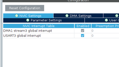

Did you enable the NVIC?

NVIC is enabled, so is the DMA Stream interrupt. The configuration is the same as my other question I posted here.
That is supposed to be an isolated subset of the main project, but somehow when I put the changes from that minimal example into the main project they do not work.

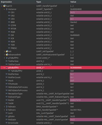

Debug the program. When it "doesn't work", hit pause an examine the state of the huart handle and relevant UART/DMA registers.
2025-09-08 12:46 PM
Thanks for pointing that out. When I debug, I set a breakpoint on the HAL_UART_RxCpltCallback which is never hit. I added a live expression so that I can see the state of the uart handle while the project runs. Here is what I am seeing
I see that the error code is 0, which is good, since it means no error. However, the gState and RxState are non-zero, and I could not find a definition for them in the generated code. I think this might be important?
