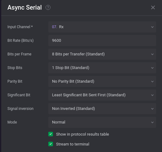

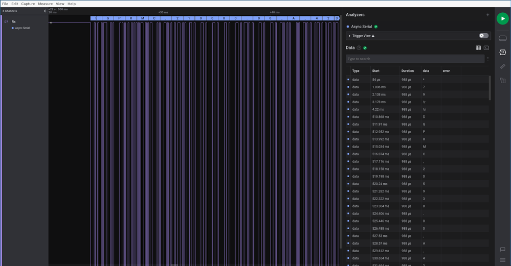

The GPS module has direct USB connection and I can see that 9600 baud with no parity and 1 stop bit is the correct configuration. My logic analyzer confirms this as well.

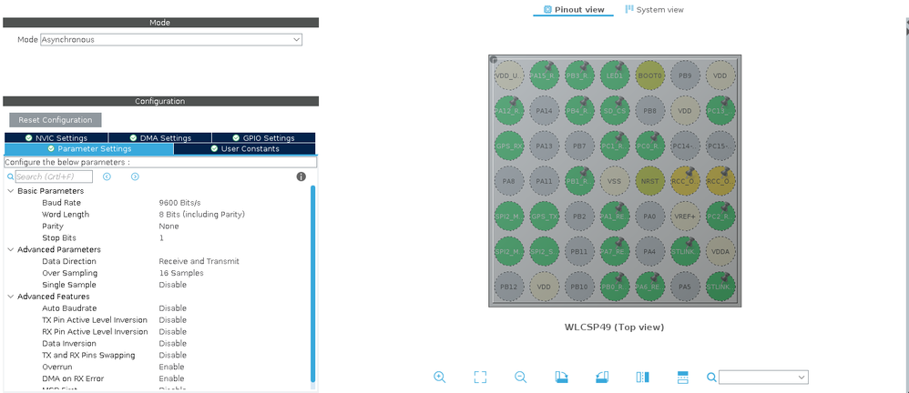

}CubeMX Setup for USUART1 (GPS UART)

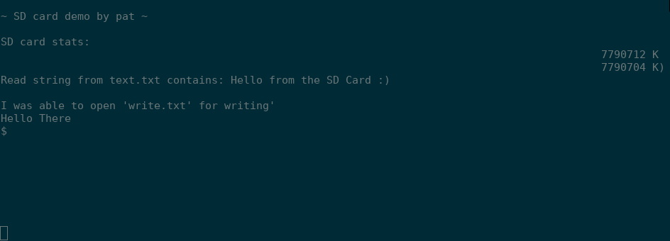

Serial Terminal Capture (Occasionally when it first polls in the middle of the window it will publish a garbage character, but as you can see it only reads the first char, then prints only the new lines from the transmit, the buffer remains empty)

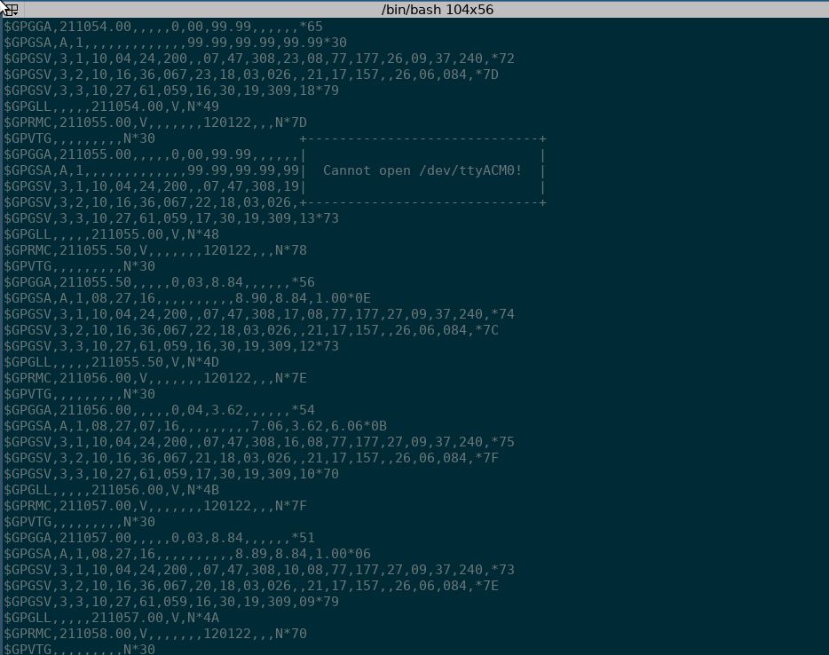

Serial Terminal Output when GPS connected directly to PC

Logic Analyzer Capture (This is what the HAL should receive, or at least some snippet of it)
