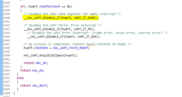

,Sure!, when the UART IRQ handler is called it disable the Rx ITbefore the call of the callback interrupt function :
I suggest to you to declare a volatile globalvariable out of the main function, and change the value of this when the callback is called:

So the receive function is just called when some data have been received and the interruption have been disabled.
