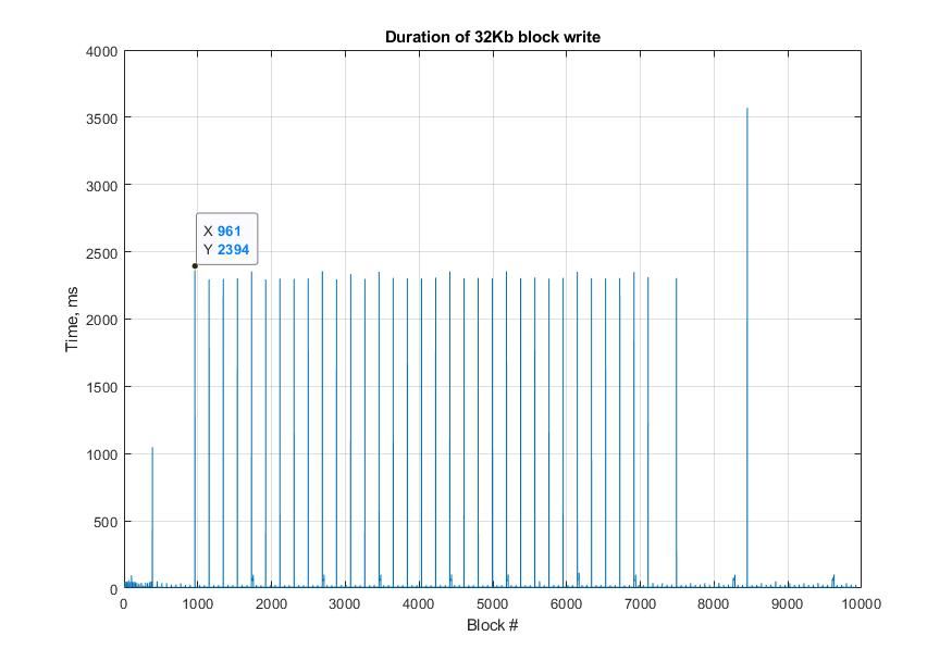

I have also been struggling with similar issue. I did some tests to measure these occasional delays.
I write 32Kbyte buffers sequentially during several minutes. Each of those buffers contains a timestamp in uS (taken from from an MCU timer and placed in the block being written). Then I analyze the recorded time stamps on my PC.
Normal writes take about 8ms (i.e. 4Mbytes/s), which actually matches the SD card class (4) write performance. However, often this time is actually higher (40ms, 90ms) and even less frequently I have really long delays up to 1-2 seconds!
If someone has already solved this issue, it would be nice to know the solution.
The above test is done on STM32L496 MCU, STM32Cube_FW_L4_V1.16.0, with FreeRTOS and DMA, but without FatFs. I start writing from sector 0 from 4-byte aligned memory buffer in SRAM.
Thank you.
