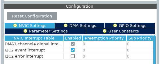

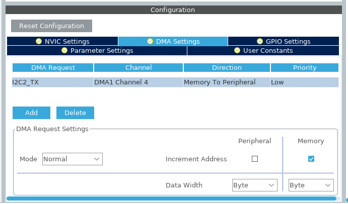

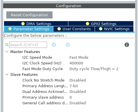

The blocking version (HAL_I2C_Mem_Write) works nicely, now I'm trying to use HAL_I2C_Mem_Write_DMA. Here are the settings as given in the configuration tool.
The resulting code generated by the configurator (I removed some comments for brevity):

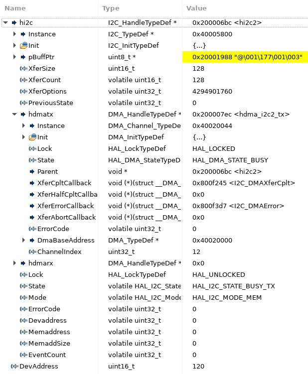

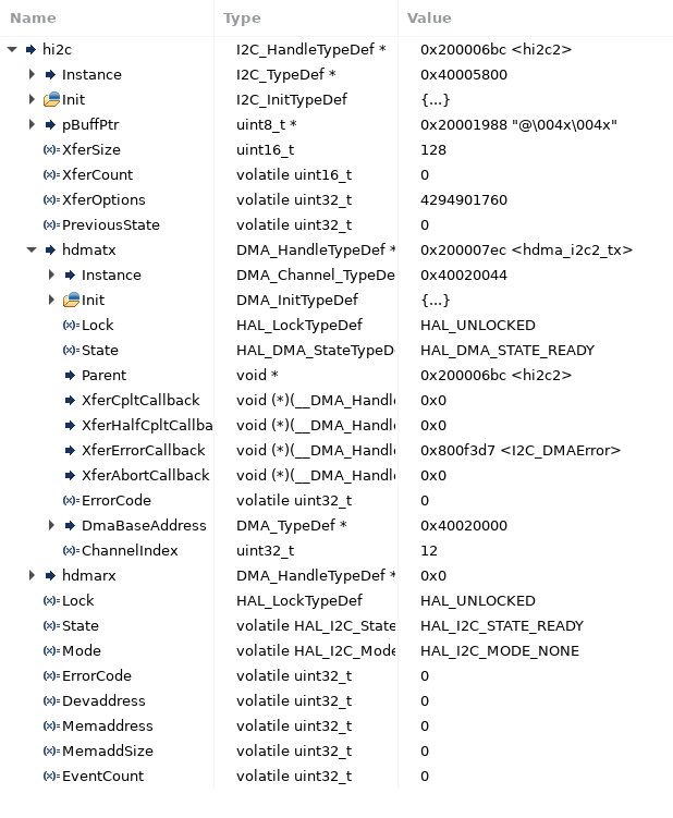

HAL_I2C_Mem_Write_DMA returns HAL_OK. When I step inside it, this is the state immediately before it returns:
Note that XferCount starts as 128.

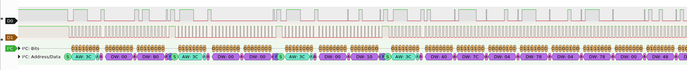

Here is the view from my logic analyzer, first the result from the blocking (non-DMA) call:

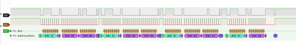

Now the result from the DMA version:
Only the MemAddress (0x40) is sent. The data buffer seems to be completely ignored.
When I place a breakpoint in the callback, XferCount has become zero, and the State and Mode are 'ready' and 'none' respectively. As far as I know this is what should be expected from normal operation.
