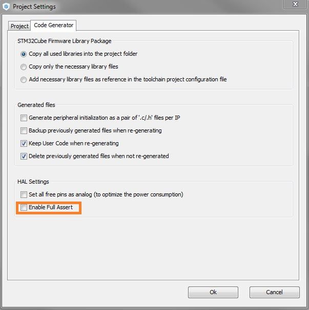

In fact, theHAL_I2C_Mem_Read() API contains a check on the MemAddSize parameter. User needs just to activate the assert parameter macro USE_FULL_ASSERT by uncommenting the following line within the HAL configuration file stm32xxx_hal_conf.h:/* ########################## Assert Selection ############################## */
* @brief Uncomment the line below to expanse the ''assert_param'' macro in the
* HAL drivers code
/* #define USE_FULL_ASSERT 1 */
This macro can be enabled also from the STM32CubeMX tool before generation the user code, by selecting:
Project »Settings »Code Generator tab» HAL Settings» Enable Full Assert, as shown below:
