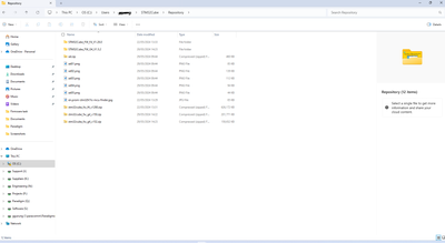

While reading the data from I2C, I see that the master is missing to send NACK.
Some fixed was done in https://github.com/STMicroelectronics/STM32CubeF4/issues/139 but those fixes are there in the code. But still sometime i see that NACK not being send out and slave pull the SDA line to low.
Is there any fix on this one?

After a long run test, what i found was not the HAL_BUSY. It is about the HAL_ERROR. Seems like BTF flag was not set.I put the break point in below code. What could be the reason of BTF not been set? Is it noise on the signal or something else. But when i see in oscilloscope, there are some spike on ACK. See in above image.
