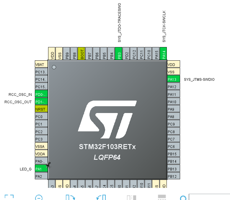

I'm trying to upload code to an STM32F103RET6 MCU and have a simple setup by now (see image below). I have attached a LED to pin PA1 as a GPIO OUTPUT and an external oscillator at 16 MHz. The other three pins are connected to the JTAG connector that goes to the STLINK v2. When i generate the code to perform a simple blink I'm having trouble with the HAL_Delay function. The code is shown below.

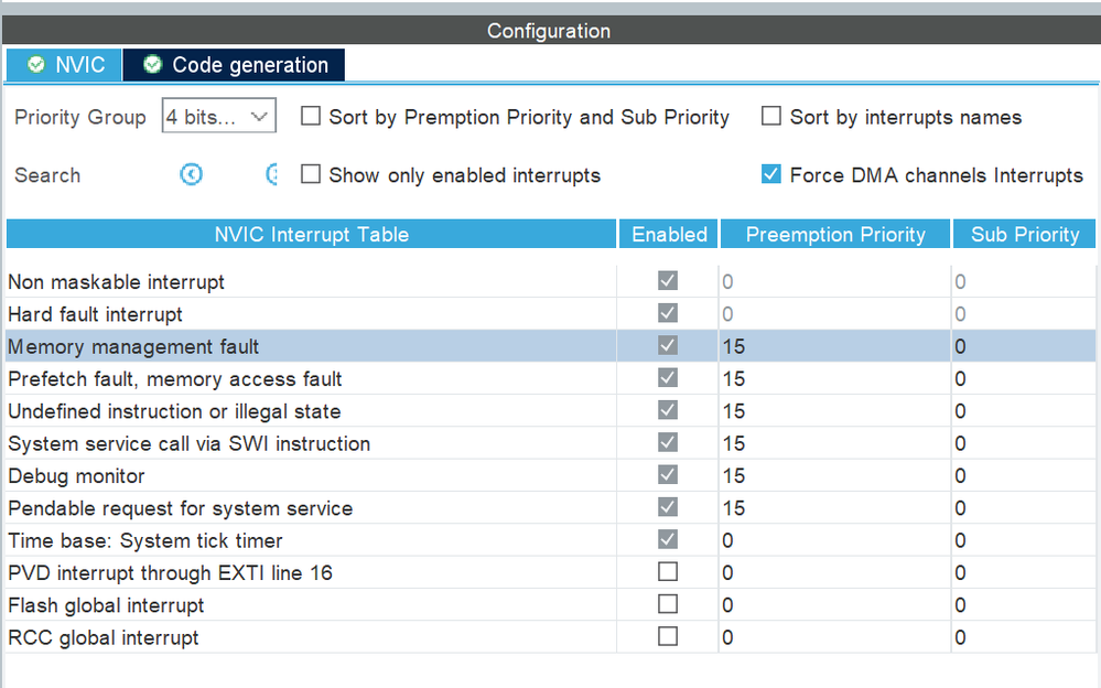

I have tried setting the NVIC preemption priority as i have seen that was the solution to many people having a similar problem and the setup is like the following:

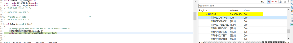

2021-05-16 11:24 AM
I don't really understand what is happening in this register. I add a screen capture in case it was useful.

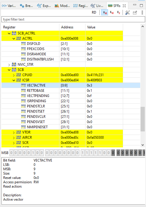

VECTACTIVE = 3. To find which interrupt it's handling, subtract 16 and look it up in IRQn_Type. In this case, it's executing the HardFault_IRQn interrupt, which means something in your program went wrong. Other SCB registers will shed more light into why a hard fault occurred.
Note that VECTPENDING = 0xF, which is the SysTick_IRQn, but it never gets there because it's in the hard fault handler.
