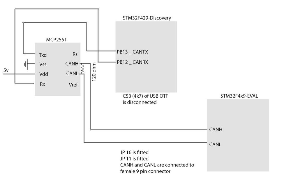

Hello, I'm trying to communicate with a STM32f4x9 EVAL board and a STM32F429-Discovery board via CAN Bus,
I am using MCP2551 transceiver IC for Discovery board, I know that CAN1 is being used by LCD and CAN2 is used by USB OTG. So I de-soldered the C53 (4k7 uf) capacitor of Discovery board (according to a video onhttps://www.youtube.com/watch?v=4fYoXGiIdDs
), I have tested everything, wirings, HAL configs for CAN, etc.. But I'm getting timeout when I call the HAL_CAN_Transmit function. I am using pure STMCube examples (STM32F4x9_EVAL\Examples\CAN\CAN_Networking), I re-configured the same example for Discovery board, using CAN2 instead of CAN1. Here is my wiring schematic:bool CANWorker::init_HAL_CAN()

What am I doing wrong? It's not because I use a MCP2551 and the EVAL board is using HVD230 transceiver instead, right?
It seems that the other not does not ACK the sent frame, am I right? What causes this?

Well, the timeout problem was a physical link issue, I don't remember what it was exactly (maybe the MCP2551s where broken, because I changed them), however, it is working right now.
I also tried without using transceiver ICs, page 4 of this document : http://www.keil.com/appnotes/files/apnt_236.pdf and it worked fine.The problem I still have, is that I can not use CAN2, receive interrupts are not called, so I changed my code to use CAN1.I you still have problem, put your configurations and codes, maybe I can help you :)2016-01-28 3:50 PM
