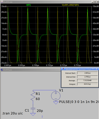

maybe i killed it -- is it very sensible to "overcurrent" (>1mA ) ?
Because i just made the write data to display a little faster on F303 with other TFT ( ILI9341 ) that day,
at first using HAL_SPI_Transmit() , needs 305 ms for a 8x10 lines grid (like a DSO sceen);
then tried direct register write : 6 ms !
Then i thought : try same on the H743 + ST7735 TFT ; after some time ( 2 hours !!!!) , i got it working (who had the idea to make this SPI so over-complicated ??? ), then it draw one screen -- and faded away forever...
So i suspect this SPI write at more speed - was too much for the tiny switch.
Simu at this speed (with 60 ohms switch) shows > 20mA peaks , and about 7mW loss :
And for now its just on my audio-player, one cpu . Next week i will check at work, whether there is any of this over sensible pins used as IO output .

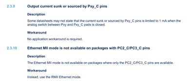

Dear @AScha.3 ,
We released last year a documentation and silicon errata on _C pin usage when configured as digital and not direct analog input for ADC .
I would suggest to have a failure analysis to see if the same cause or another one .

My errata sheet from 6/2022 ... ok.

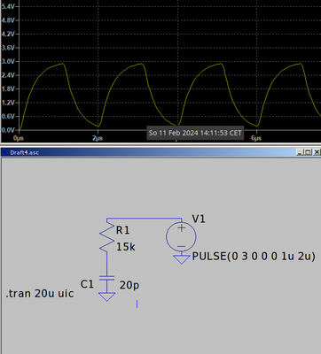

But still super slow switching now - after 1 1/2 years working without obvious problem as spi tx.
...and switch is on. (I never changed/touched sysconfig.)
So the "analog switch " died away ?
To get such a signal with 20pF load, i tried simple simu :
Looks similar - if "switch" has about 15k ohm now ! ?
What else could i check ? Or is it just -- switch dead now, because "overload" with some 48Mbit data ?
But pin still ok for analog use -> ADC3_IN1 ?
