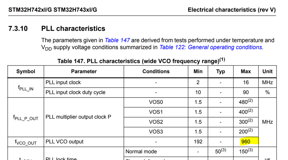

I seem to recall the max VCO speed having conflicting information.
Yep, here it is. I suspect the real limit is 960 MHz. Or perhaps there really is a different limit for different chip revisions. Note this is for rev V hardware.

2021-09-03 6:46 PM
I can confirm this from my User Manual. (The same you linked) Most likely explanation: The Reference Manual (RM0433, Rev 7 - the only H743 one linked on teh STM32H7 official page) is incorrect. It's listed as 836Mhz in Figure 47, and in 12 individual register-section config fields. 960 Mhz isn't mentioned anywhere.

I have 12110 Rev. 8 with PLL VCO Output listed as 960 MHz max

Hi @DOCon.1 ,
The same error was spotted in VCO frequency discrepancy in STM32H743 datasheet and reference manuals.
@Imen GH took already the action to raise an internal request for document update.
It is worth to make the update for figure 47 (PLL block diagram) in RM0433 as well. RM0399 has to be considered as well.
