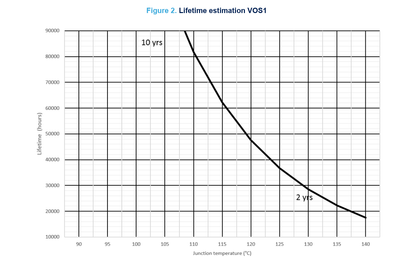

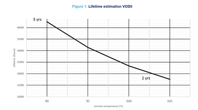

You need the max. speed 480M really ? I have my cpu at 200M and vos1 , because cpu lifetime... ->
see AN5337 :
vs

Thanks for the information on impact of operation mode the lifetime. I was not aware and it is important.
