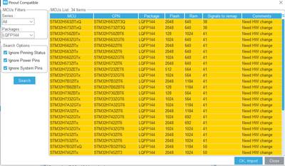

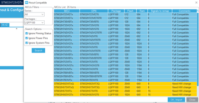

CubeMX will list pin-compatible parts. Load your chip, configure it if you want, then go to Pinout -> List Pinout Compatible MCUs.

Hello @LCE
You can use CubeMX Pinout compatible feature to find the list of pin-to-pin compatible MCUs.
