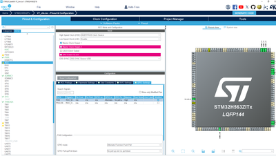

@Nicolas P. @FBL I found the issue - one step further. CubeMX defaults the IO Speed setting for the MCO1 pin to low speed when it is enabled within the pin config (chip map). This is done in the MX_GPIO_Init. But the setting for the SystemClock is done BEFORE this MX_GPIO_Init.
So the fast IO pin type setting of the SystemClock_Config gets overwritten with a Slow output setting for the pin.
I just put into the user code space another call to set the GPIO very fast again after.
But this is worth a look by ST that you may want the tool to determine for the user which IO speed mode the pin assignment should be in based on what clocking speed they have configured in the Clock setup tool, or the MCO should be left alone when you get to your MX_GPIO_Init.

@VT_Jim Attached the updated IOC for reference.
You can configure MCO clock speed in this field.
