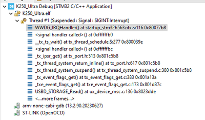

I have tested the SD (SDMMC1) is working fine. It reads my cards. I have also gotten the USB to show up on my PC as MSC device but with failure. The event logs for Windows show that the USB has the correct Vendor ID, etc.
But ThreadX crashes on me the moment I connect the USB cable.
I selected to not use VBUS sensing. My device is self powered and doesn't use the power from USB.
I had to manually add the line of code to initialize the RPU (pull up) on D+
So far, after more than a day of debugging, I know that drivers and event handlers are not working if the UCPD is not enabled. But if I enable it, i lose the pins I need.
Can these H563/573 chips be used with the older USB ports without the UCPD (power delivery) and work within the CubeMX setup framework?
The IRQHandler is missing for something I believe. But not sure how to tell which one?

@AScha.3 I checked and confirmed no watch dog is active. It is not enabled in the CubeMX and doesn't appear in my code that I can find. I believe that reference in the debug trace was that a RTOS watchdog service had an event that it trapped and when this event (interrupt) happens, it tosses the code into an assembly line forever loop within the TreadX assembly code. In the code above that line it says this loop is to preserve the debug stack for unexpected Interrupts.
