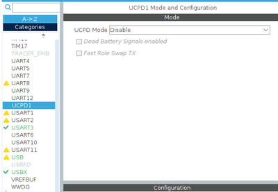

Just fyi : i have never activated ucpd , but USB working as it should, so dont activate it:
(here on H563ZI )

Also on my H563 with threadx and Usbx it's working, just need to enable power, as I needed to do, because Cube did not. Just try...

>CubeMX does not permit you to use those pins for a different function if you want to use USB.
Would you please share a minimum of software setup to reproduce? I see no issue on myside. Drop your ioc here to investigate. Attached mine. There should be something missing. Make sure to use latest version of CubeMX.

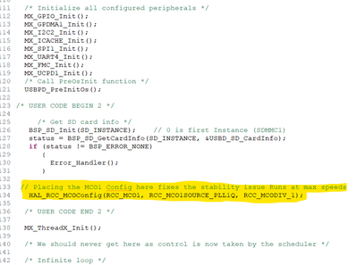

@Nicolas P. @FBL Question about the MCO1 signal output. In my application I started it off at 20MHz output. That worked perfectly. Clean square-wave. When I tried to go to 40MHz, the signal drops to only 300mV vs the 3V swing I get when at 20MHz. I even removed a resistor I have in series with the output and probed the resistor pad. I stepped through the divider range for the MCO1 output with using the PLL as the source. At DIV10, great, DIV8, great, then at around DIV6, it becomes very strange and stalls to a very low output voltage on the pin. All other aspects of operation in the system seem to continue to work normally. So far it seems it is just the MCO1 pin that has an issue. I can't find anything in the data sheets yet that would indicate that it is not meant for outputs over ~ 30MHz or so. Can you think of what might make it drop the voltage swing level like this when under no load?
I will be using this MCO1 to clock a small FPGA that runs beside the STM32H563.
I was hoping to be able to clock up to about 100MHz if I can using that pin.
2024-04-05 4:19 PM
@Nicolas P. @FBL Found the issue solution for the MCO1 startup.
If I use it as configured out of CubeMX, it places the MCO division and source setup in the SystemClock_Config which is the very first thing on code startup.
There is some kind of internal problem where this MCO port fails to work correctly.
However - if I place the MCO config after the other peripherals are started at this location below, it works every time all the way up to my PLL1QCLK of 200MHz. So either some other Init after SystemClock messes it up or there is a need for added delay before this MCO1 can start at all speeds. When it failed out of Cube, it is at the correct frequency but very low level. at below about 25MHz it was working correctly out of Cube.
