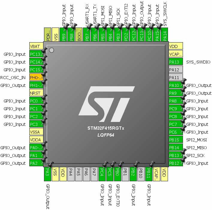

In any design i try to check if everything is ok, but i used STM32CubeMX to see if i have any conflicts, and i had none, since it was possible to select RCC_IN as CMOS clock source, and PH1 pin as GPIO_Output.
