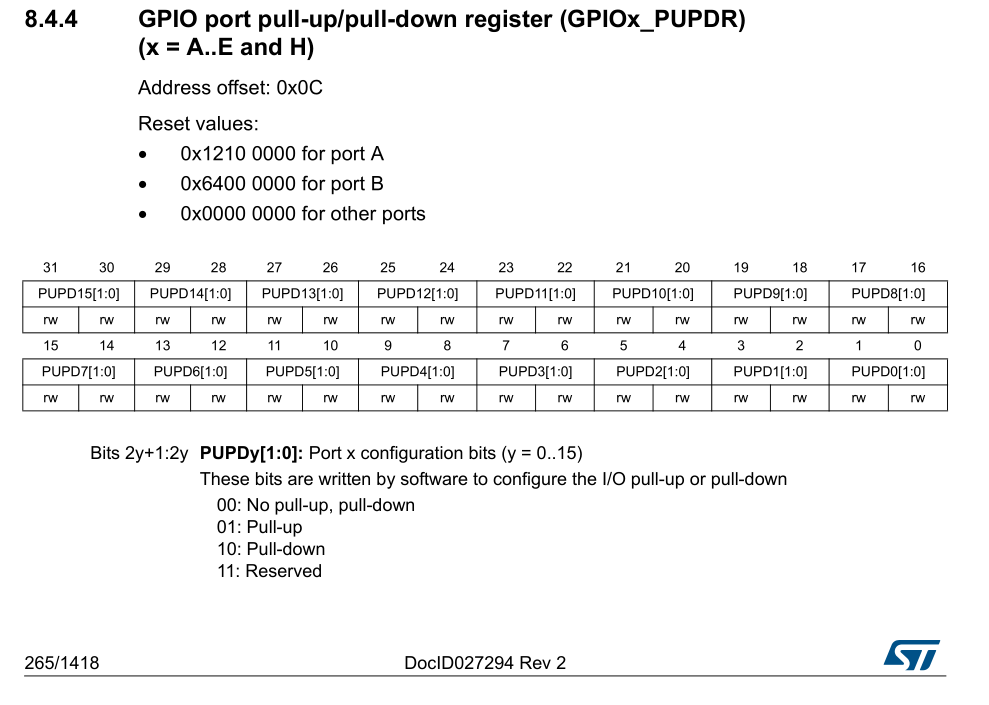

I see this note in the Reference manual, RM0351
8.4.4 GPIO port pull-up/pull-down register (GPIOx_PUPDR)
(x = A..I)Address offset: 0x0CReset values:• 0x6400 0000 for port A• 0x0000 0100 for port B• 0x0000 0000 for other portsindicating PB4(jtag/swd) is pulled up at reset, not PB8

you should check it.. this is the wrong reference manual for that chip.

I think in your example PB1 has pull-up nor PB4, if I read the datasheet correctly. For my MCU:
It would seem that:
PB15 is pulled up
PB 14 is pulled down
PB 13 is pulled up.
2018-04-05 5:18 AM
That's how I read it too, (it was PB4 pulled, up, hard to read,)
