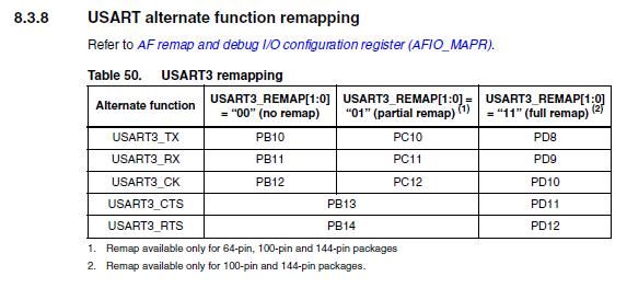

Normally USART4 if you program the GPIO as AF
To get USART3 to move there use
GPIO_PartialRemap_USART3
or
GPIO_FullRemap_USART3 A Partial Remap would move RX, TX A Full Remap would move RX, TX, CTS, RTS, CK

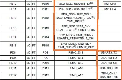

1) The left box is the NORMAL mapping of USART3, the right box is a FULL REMAP of USART3. Look at the titles of the columns in the manual.
2) You will have to set the GPIO's attached to the peripheral (ie AF / Alternate Function - not a GPIO) for the outputs. And floating for inputs.2011-05-17 5:26 AM
