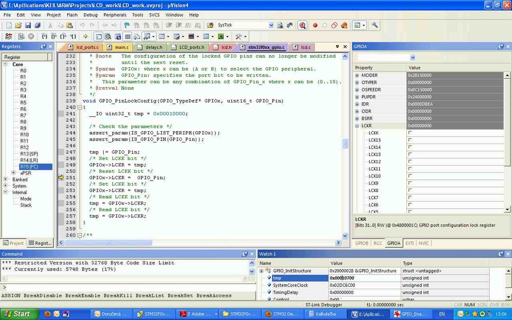

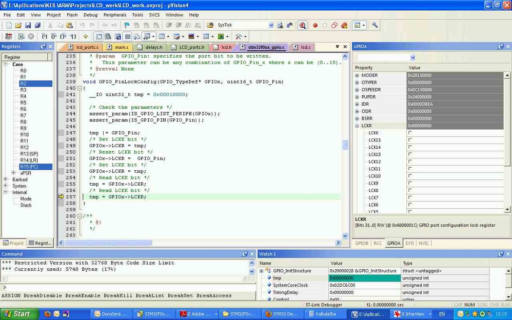

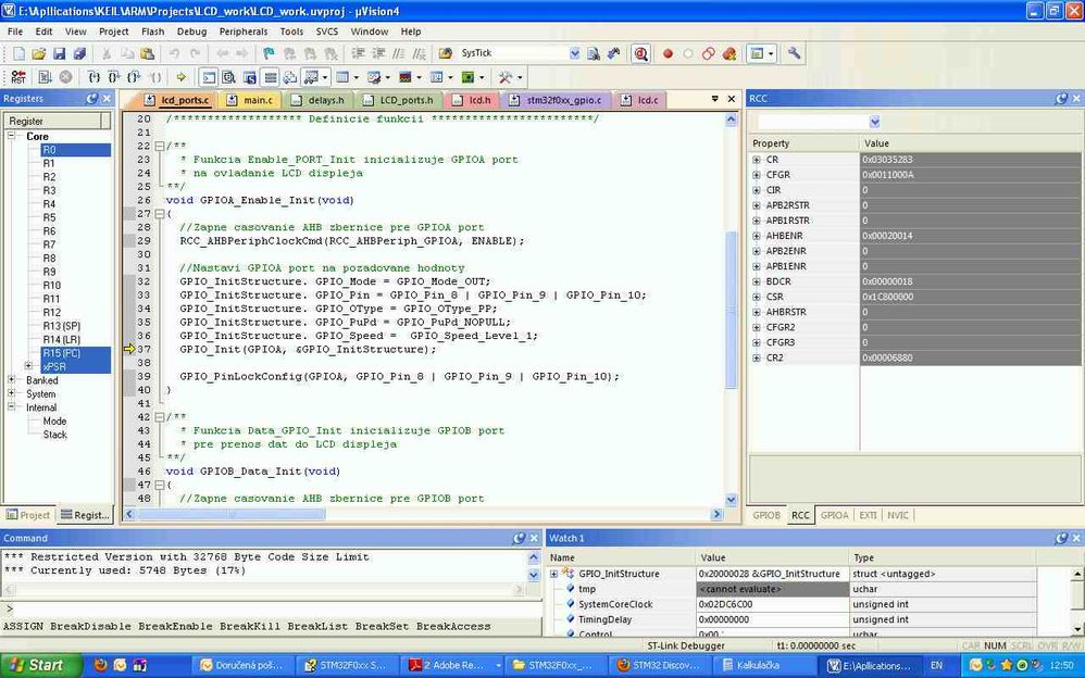

Sequence of the code I wrote is the same as you wrote here. 1. I tried to debug it by hardware degugger ST LINK and I watched LCKR register of given PORT in system viewer windows. But nothing changed in LCKR register and as I mentioned I used the same sequence as you in your example. 2. When I tried to debug it by software KEIL simulator it everything worked well. All locked bits were set in and LCKK bit was set. I watched it in system viewer windows again. I am little bit afraid, that my MCU is little bit destroyd. At least LCKR register. I see it, that I will have to try it again. Even though thanks for your help.2012-10-31 3:46 AM

Sorry it did not add printscreens. Why?
