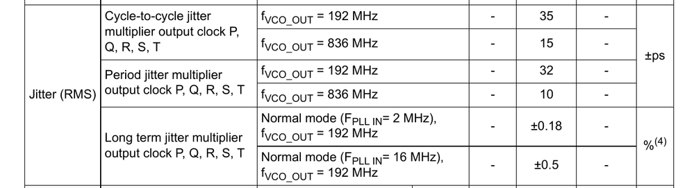

see ds also, about the jitter to expect from the PLL : here for H7Sxx

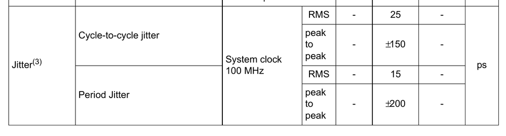

or for F411 ...little bit worse :

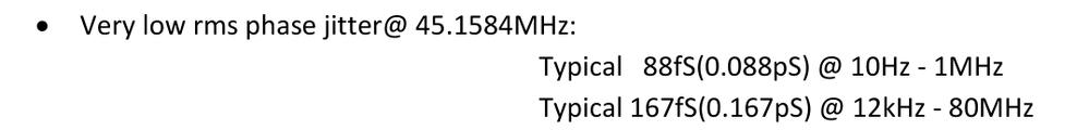

and see the jitter of a low noise oscillator (i use it for my audio player): AS318 b

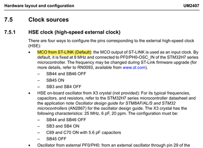

The reason this is happening is that "HSE Bypass" is driven from the incoming clock signal. On the NUCLEO-H723ZG this is an 8 MHz signal driven by the HSE within the ST-LINK. So it will have the same jitter as HSI.
The user manual goes into some detail about this.

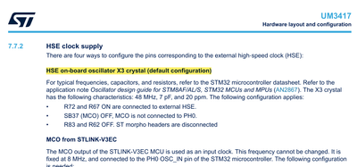

This is in contrast to the NUCLEO-N657X0-Q where the default HSE is the onboard crystal. Again, the user manual covers this:
2025-12-22 8:47 AM - edited 2025-12-22 8:47 AM

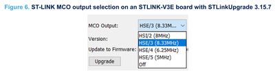

Hard to believe really. Double check the clock configuration of your project. The PWM output frequency stability & jitter should be and ARE exactly the same as MCU clock input parameters. On most of Nucleo boards (excluding STM32L series ones) it is possible (but not obligatory) to use 8 MHz clock from ST-Link (8.33 MHz option is available but not default on Nucleos with ST-Link 3). On newer ones (C0, H5, ...) onboard HSE oscillator or generator is included.

@gbm On ST-Link V2 chips where the st-link uses a 8 MHz crystal, you would be correct. On the STLINK-V3E (which the NUCLEO-H723ZG has), the ST-Link chip uses a 25 MHz crystal and can't do this. There are a variety of outputs, but the default (8 MHz) is derived from the HSI.
Overview of ST-LINK derivatives - Technical note
