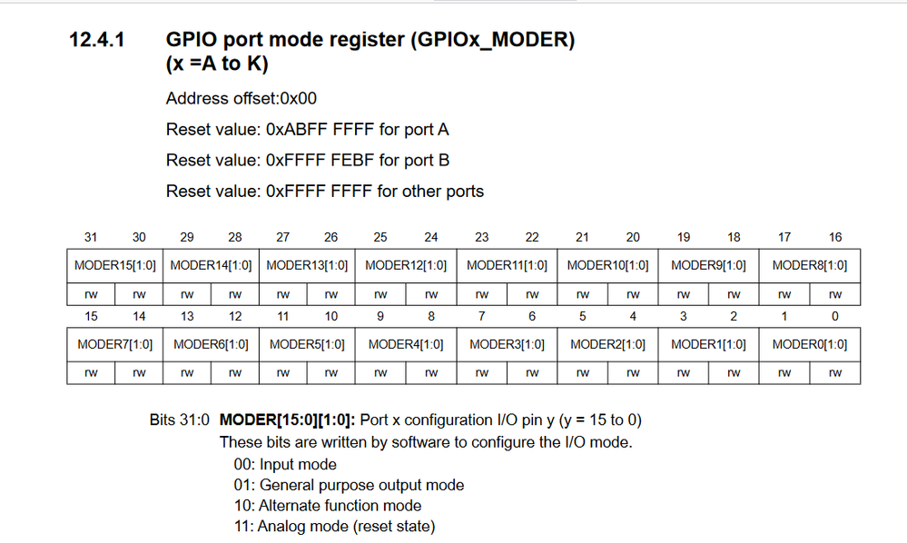

The Reset_Handler in startup_stm32h745xihx.s looks correct, for example all GPIOJ registers show values 0xFFFFFFFF.
I don't have access to many of the pins, but interestingly with the CPU paused at Reset_Handler, some pins are low (ex. PJ3) yet others are High (PJ2).
2021-11-04 3:24 PM
If the register indicate the pins are in high impedance analog mode, the pins are probably in high impedance analog mode. You would need an external resistor to force them high or low.
These are mature chips, there's unlikely to be showstopper problems like this in the silicon. Doubly so if the pins behave as expected when configured as GPIO outputs. Much more likely the problem is in your code or hardware. Revisit assumptions, recheck hardware.
