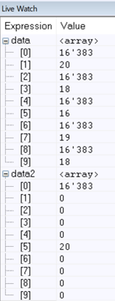

I have a Nucleo-u575zi-q board. I started to program with this board and applied some examples within the STM32U5 Workshop.
Unfortunetly, I could not overcome to run the GPDMA 2D addressing example.

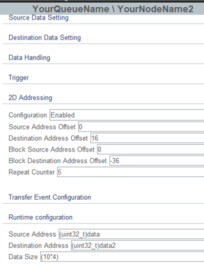

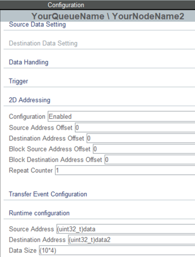

In the 2D addressing example, I configred two queues in the linkedlist. First queue is transfer the ADC samples to the buffer (data), and second queue is transfer the data to the other buffer (data2) with the 2D adressing.
My buffers (data and data2) have 10*4 sizes (uint32_t data[10]; uint32_t data2[10];).

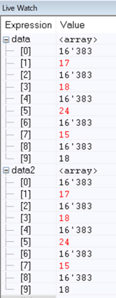

When I configured the second queue in the , buffers have same
contents because 2D adressing is not run.
When I configured the second queue in the , again 2D adressing is not run
, and mcu is locked.

Hello Said @[smcinar] ,
Thanks for your question.
Each time the current transfer ends the GPDMA automatically reload the next transfer parameters, and starts it. (without CPU intervention)
Also, I have two questions for you :
Remark: on both screenshot it's written YourNodeName2.
