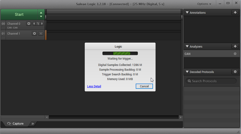

I try to send data via CAN from the nucleo board to a USB-to-CAN device (peakCAN).
I configured PA12 and PA11 as FDCAN1_TX and FDCAN1_RX. I measured pin 12 and pin 14 on the CN10 connector with a salea logic device, but got no valid frame. Pin 12 stays high (3.3V) and pin 14 remains low (0V).
I also tried to change the PLL-frequency for the CAN peripheral to 40MHz as mentioned in some other posts (seen in the snippets below) - but it has the same effect like my implementation with 36MHz...
Can anyone help me with this problem? Thanks a lot...
