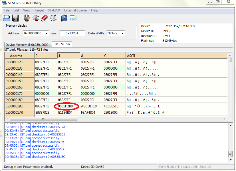

Is there any specific address location in generated binary file so we can know the size of that binary file?
Using this, in the firmware to read the size of binary file from that location and use it in our application.
2019-07-03 8:53 PM
>> Is it require to configure some other things which I have missed?
Are you using the _flash_size symbol?
.endof 0x080086fc 0x0
0x080086fc _limit_flash = .
0x000086fc _flash_size = (_limit_flash - g_pfnVectors)...
.word UsageFault_Handler
.word _flash_size /* symbol you define in .ld linker script */
.word 0
.word 0

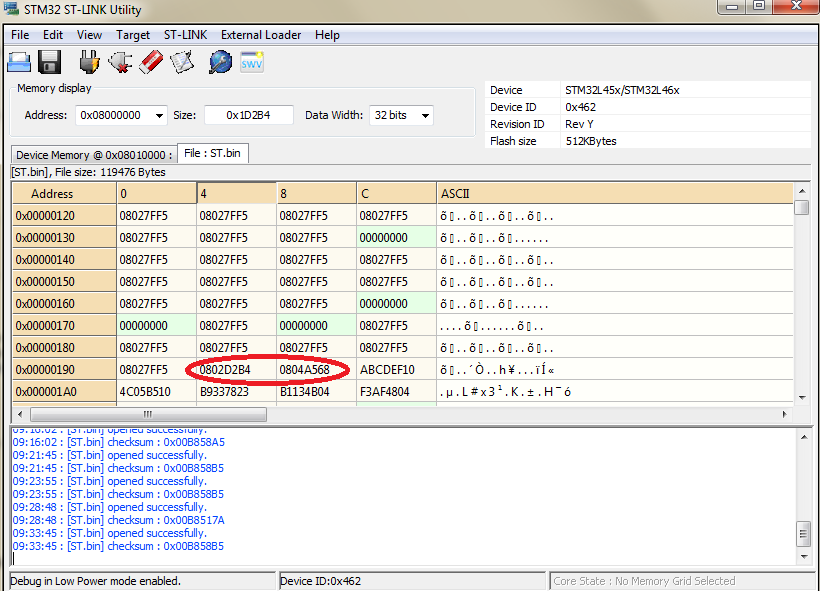

@Community member Yes, I have already used _flash_size symbol in the startup file.
.word I2C4_EV_IRQHandler
.word I2C4_ER_IRQHandler
.word _limit_flash /* symbol you define in .ld linker script */
In the linker file, symbol is used as per your suggestion. But not working.
2019-07-03 9:08 PM
If that doesn't work try
.word _limit_flash - g_pfnVectors /* compute size */
2019-07-03 9:17 PM
Yes, Finally it is working. Thanks for such an amazing support.
