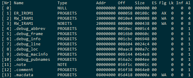

The elf file has no knowledge of flash sectors. Elf only contains information how the application is laid out in memory. The application loader will then use this information to place the correct sections in the proper flash addresses and will take care about flash sectors erase/write operations.
You only need to make sure that your extra section does not overlap with your application code. In this snapshot you see for example that the ER_IROM1 section produced by the toolchain starts at 0x08000000 and its size is 0x108c. The extra section that I added '.macdata' starts from 0x08004000 and has size of 0x0a.
Note however that you can also use ST-Link to flash specific files to specific addresses so you can avoid ''combining'' the two files if you wish.
