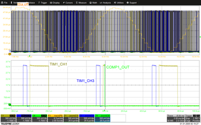

In the attached screenshot you can see the first small signal measurements. In yellow (C1) the output of TIM1 channel 1, in blue (C3) the output of TIM1 channel 3 and in green the output of the COMP1. As you can see, the comparator output limits the on time of TIM1 channel 1 (as expected) and it looks like that the CNT is also reset in this case (because of the missing TIM1 channel 3), which is also somehow expected, because in the RM0444 the SMS description mentions this for the Reset mode. But this is not an option for the final application. As shown in the picture of the first post, after a limited tSw,on the defined tSa,off should occur. Any hints to improve this?

Based on your drawing, I tried to implement both signals within the combined PWM.
- Sw: TIM_CH1 = CCR1 & CCR2 (where CCR2 = ARR)
- Sa: TIM_CH2 = CCR3 & CCR4
The ETR configuration remains the same.
In the software I update the registers every 300us. As you can see in the figure below, the tSa,off (orange) graph changes as expected without unexpected jumps (NICE).
I also tried to simulate a break situation of the tSw,on. The comparator output limits the on-time of TIM_CH1 as expected without changing tSw,on or other timings.
But if I understand you correctly, your idea was to run the Sa with the combined PWM function and the Sw with the PWM2 mode. I have tried this and it works as well. Why do you prefer this approach? Because with this approach one register less has to be written?
