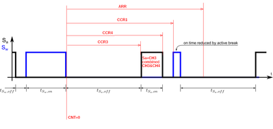

For a project I would like to generate two interdependent PWM signals (Sa and Sw in the attached figure) with the STM32G0. The constraints/tasks are as follows:
The times for tSa,off and tSa,on are thus adjusted every 300us. The time tSw,on is limited cycle by cycle by the active break.

> How is it possible with this concept to limit the on time of the Sw (tSw,on) with a comparator signal (active break)?
So when a comparator goes high, you want the pulse to be low? Not sure, but there's likely a way. Definitely a solution in hardware with an AND gate.
> How can I make sure / find the time when the timer just rolls over? An Interrupt may be too slow and not possible in the final application.
Assuming CCR1 is the timer value of the start of the first blue pulse:
100us is plenty of time to change a few registers.

Timer period starts at beginning of Tsa,off. Tsa,on generated using Combined PWM mode as TDK said above. Tsw,on normally generated using the plain PWM2 mode on one channel, as timer period ends with end of Tsw,on.
Premature end of Tsw,on accomplished through feeding COMP output to TIx or ETR (see TIMx_TISEL or TIMx_AF1 registers), setting that signal as Slave-mode controller's input (TIMx_SMCR.TS) and setting Slave-mode controller to Reset in TIMx_SMCR.SMS.
Update all required TIMx_CCRx together with TIMx_ARR in Update interrupt (or learn how to use Update-triggered "burst" DMA through the TIMx_DMAR/DCR mechanism). Enabling ARR/CCRx preset (TIMx_CR1.ARPE & TIMx_CCMRx.OCxPE) helps.

> I fully understand the logic of your propose, is there a function (callback function) which pops up when CNT < CCR1? Or what is your idea to monitor this?
Literally read the register and wait for the condition. The update event happens when CNT=0. You could also use that, but it is subject to more delay.
__disable_irq();
while (TIM1->CNT < TIM1->CCR1);
while (TIM1->CNT >= TIM1->CCR1);
TIM1->CCR1 = x;
TIM1->CCR2 = x;
TIM1->CCR3 = x;
TIM1->CCR4 = x;
TIM1->ARR = x;
__enable_irq();Or follow the idea from @waclawek.jan to us DMA to do the same on the update event, which will be even faster. Better solution, harder to program, though.

By using preloaded ARR and CCRx registers, the time window for update is one whole timer cycle, from Update to Update. Although, even with DMA, don't expect 5 registers (ARR..CCR3) to be updated within 400ns.
Tackle this one step at a time. For testing, you can modify the ARR/CCRx registers in Update interrupt, working with longer pulses/period; proceed to DMA later.
