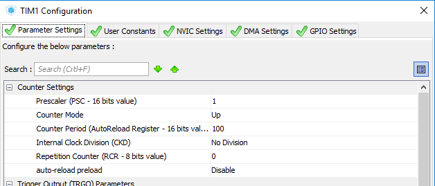

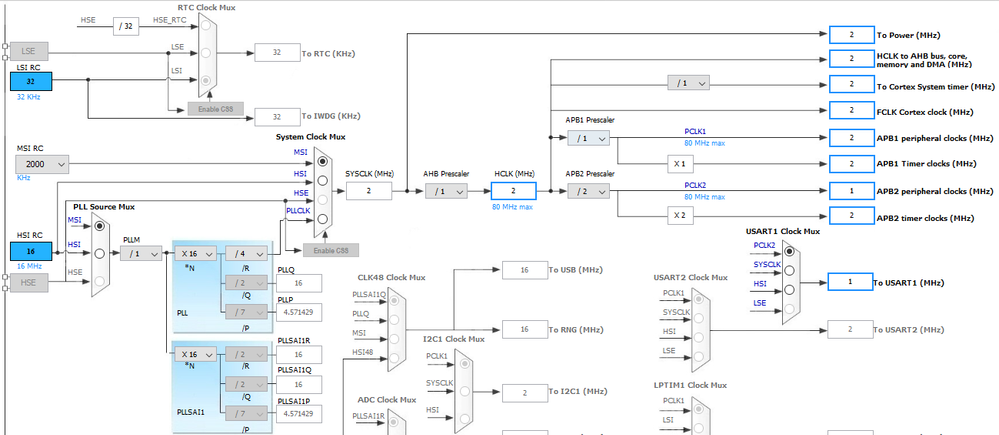

2018-09-27 10:14 AM
@Khouloud GARSI
Attached are my clock tree and timer setting for PWM 10 kHz on Timer 1 Channel 1. As you can see my prescaler is 1, so it's taking the 1 MHz instead of 2 MHz from APBx Timer Clocks.
2018-09-28 2:27 AM
Hi @XP.1acheco ,
In your case the APB2 timer clocks is equal to 2MHz.
Below is the equation that we use to calculate the frequency:
PWM Frequency = [Timer Fresuency ] / [(Prescaler+1)*(Period+1)] ; Since your Prescaler is one, the frequency will be divided by two (prescaler+1).
In order to have your expected frequency you should set the timer prescaler to 0.
Khouloud.
2018-09-28 6:49 AM
Hi @Khouloud GARSI ,
Thanks for your patience.
If I want 10 kHz, then applying the formula with prescaler one and counter period 99 I have:
PWM Frequency = [2 MHz] / [(1+1)*(99+1)] = 10 kHz
Why do you say my prescaler should be 0?
Let me see if I understood the concept: APBx timer clocks are specifically for timers, and APBx peripheral clocks are for the other peripherals, right?
