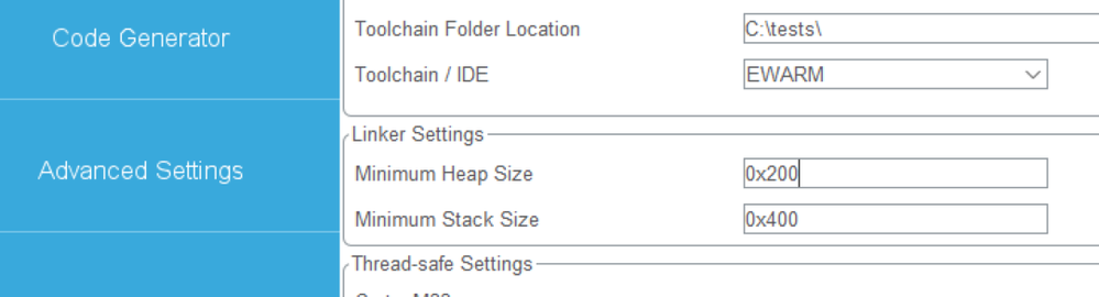

To modify thus value , you can check :
Foued

Hi, thanks! I did check already this Project Manager window and saw these values.
Now, 0x200 and 0x400 are not much, so I am interested about the maximal values, as these are Minimum Heap/Stack Sizes.
