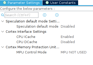

2024-05-23 12:36 AM
Caches D/I you can switch on at start, in Cube set it: (register setting done at start)
Problem with D-cache : when anything else, than the core/cpu moves data , (the DMA), the core/cache dont know about this and will use its cached data, so you get data inconsistency, cpu/cache data no more same as in RAM.
So with D-cache on and DMA , you need cache management or MPU settings, to define not cachable areas (that are used by DMA). But at start, if not needing the top last 2% performance , that D-cache might improve speed, just leave it off. Using I-cache (program->Instruction cache) is more important and creates no problems, because program is always executed by the cpu and nothing else .
