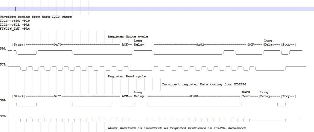

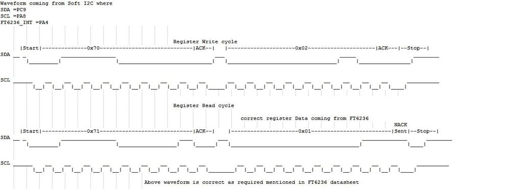

I have managed to initialize the FT6236 touch screen controller from Soft I2C successfully but when i initialize the same using Hard I2C3 core inside STM32F407VG, thenFT6236 touch screen controller is not giving the values at all. Differences between waveforms in both cases are attached herewith. Please! help me to correct the code attached below.
