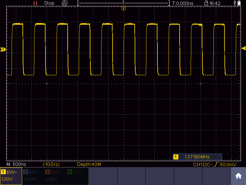

I initialized TIMER 1 to run from 137.5 MHz frequency. I set the prescaler = 0, the period = 100 and set channel 1 to toggle the output. I attached my scope probe to the TIMER 1 channel 1 output pin (PE9, CN10.4) and I measured the frequency . It was anything between 1.371 and 1.373 MHz, instead of 1.375 MHz. It was very unstable.

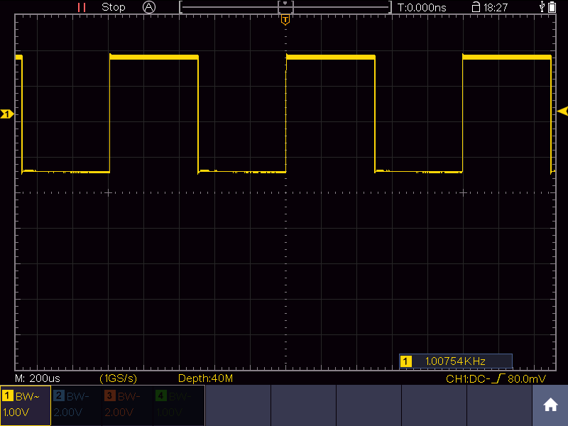

I modified the prescaler = 5 - 1 and period = 27500. The timer 1 divides with 5 * 27500 = 137500, so I should get 1000Hz. But I get anything between 1006 and 1008 Hz...

I've told you already that STLink3's 8MHz output is not derived from crystal (which means it's derived from its HSI). And your symptoms confirm it. What's the point of your repeated posts, then?
And no, 'F723 used as STLink3 cannot generate 8MHz from 25MHz.
In CubeProgrammer you probably can switch STLink3's output to a different frequency, derived from the 25MHz crystal. I don't use CubeProgrammer nor STLink3. There are several related threads on this forum, search.
