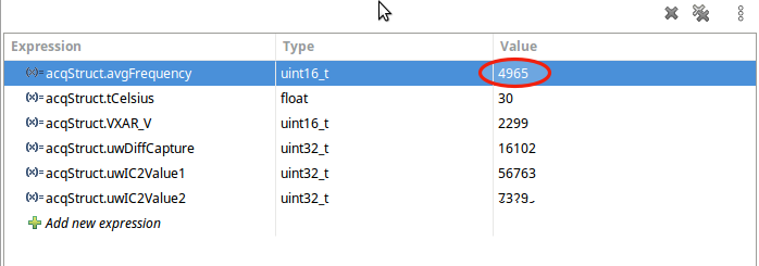

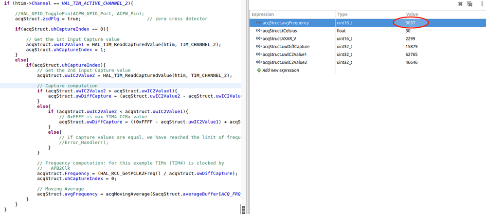

}The frequency computation is performed in HAL_TIM_IC_CaptureCallback routine and here's the result form an input frequency of 50.00Hz:
The result is 5037 that means 50.37Hz and the 0.37Hz does not a problem so far. The problem is when I pause the execution, restart and resume it. Then the result sometimes falls in 5037 (the same result than before) but sometimes is 4965 as shown:
The result changes when I do a pause, restart (reset) and resume the execution from the IDE. How can I manage to always get the same frequency result after successive restart cycles?
